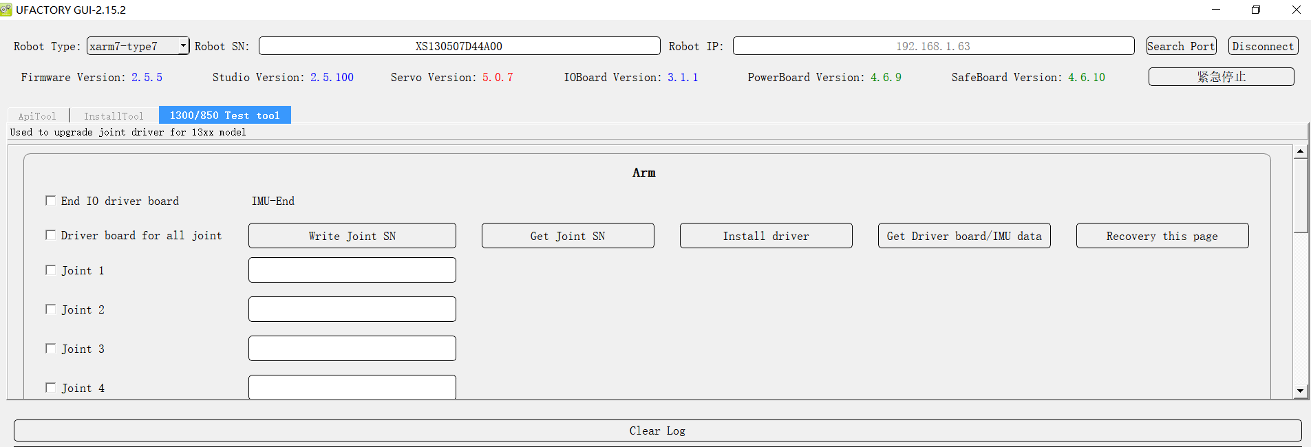

- Enter the IP address of the robot and click [Connect]. It will display the current servo version (e.g., V5.0.7) as shown in the image below.

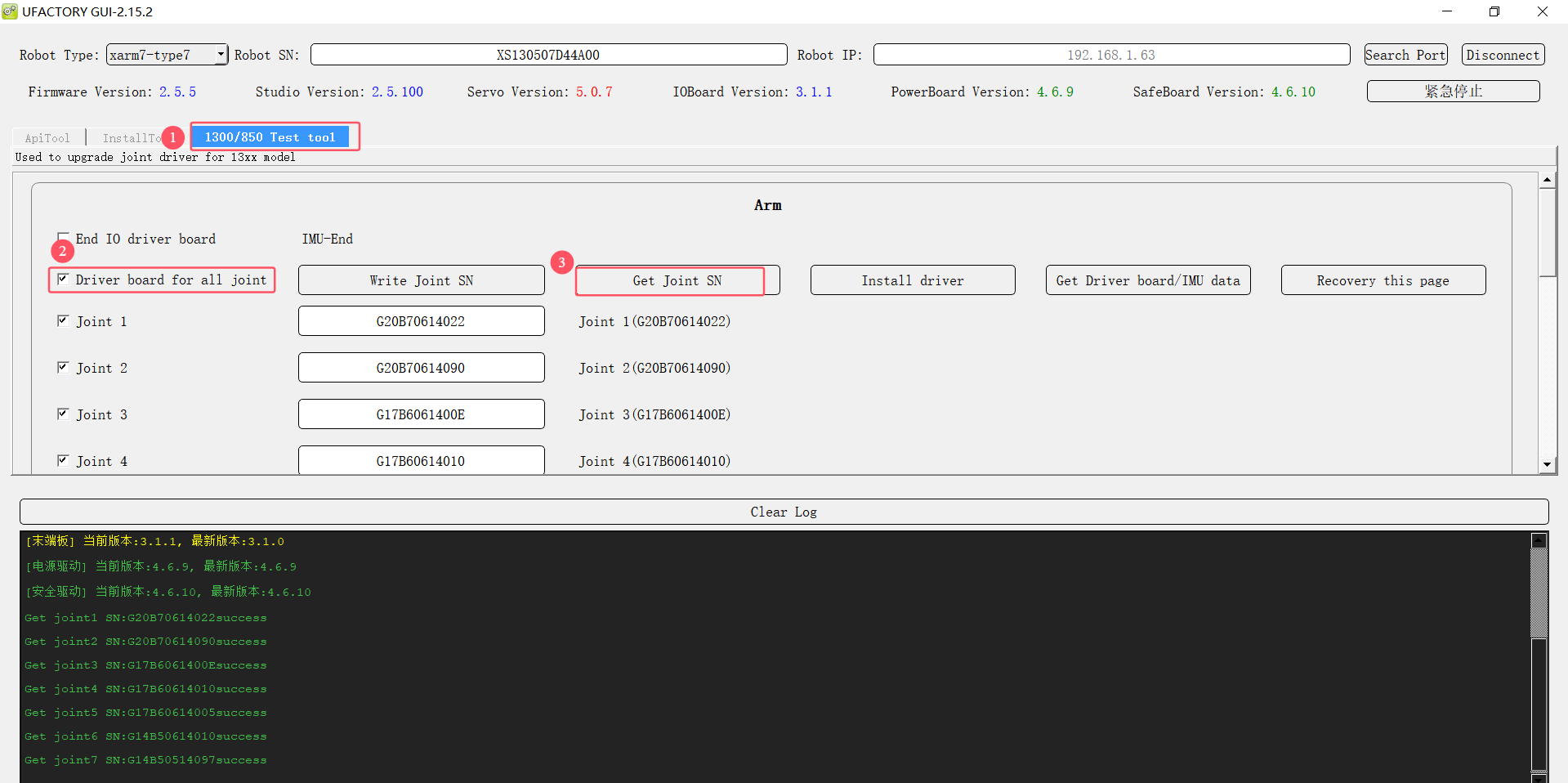

- Switch to [1300/850 Test Tool], select "Driver board for all joints", and click [Get Joint SN]. It will display the serial number (SN) of each joint.

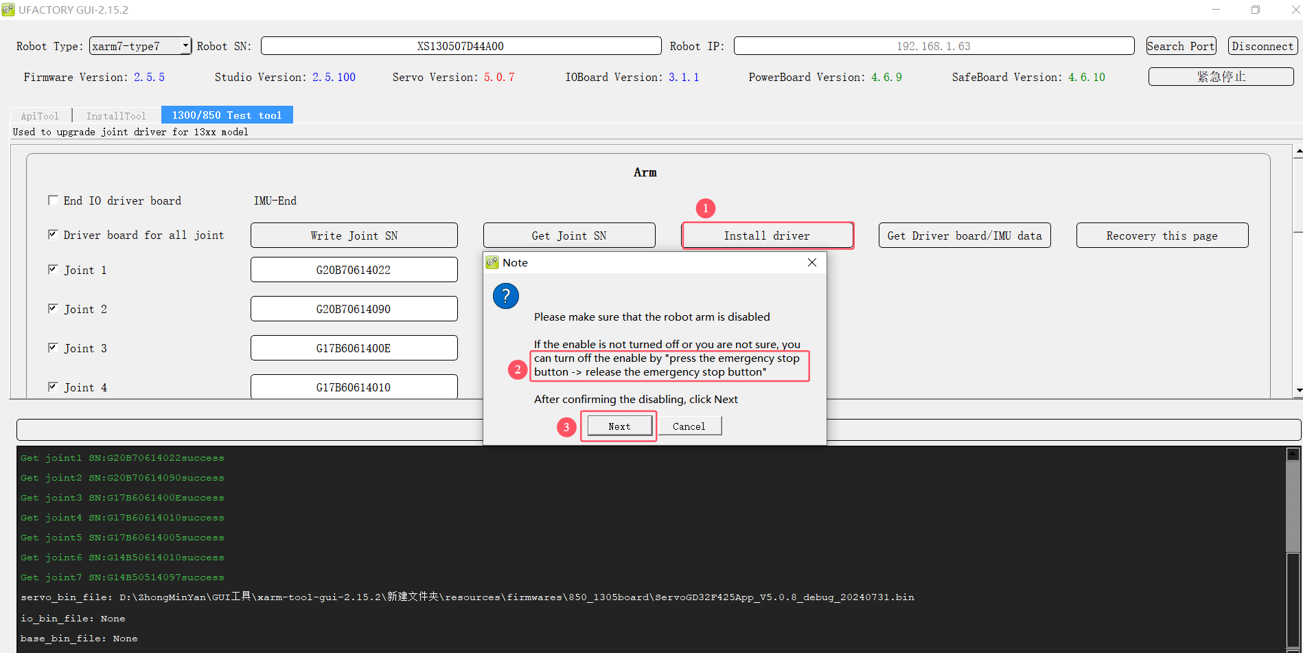

- Click [Install driver], press down the E-STOP button and release it, then click [Next].

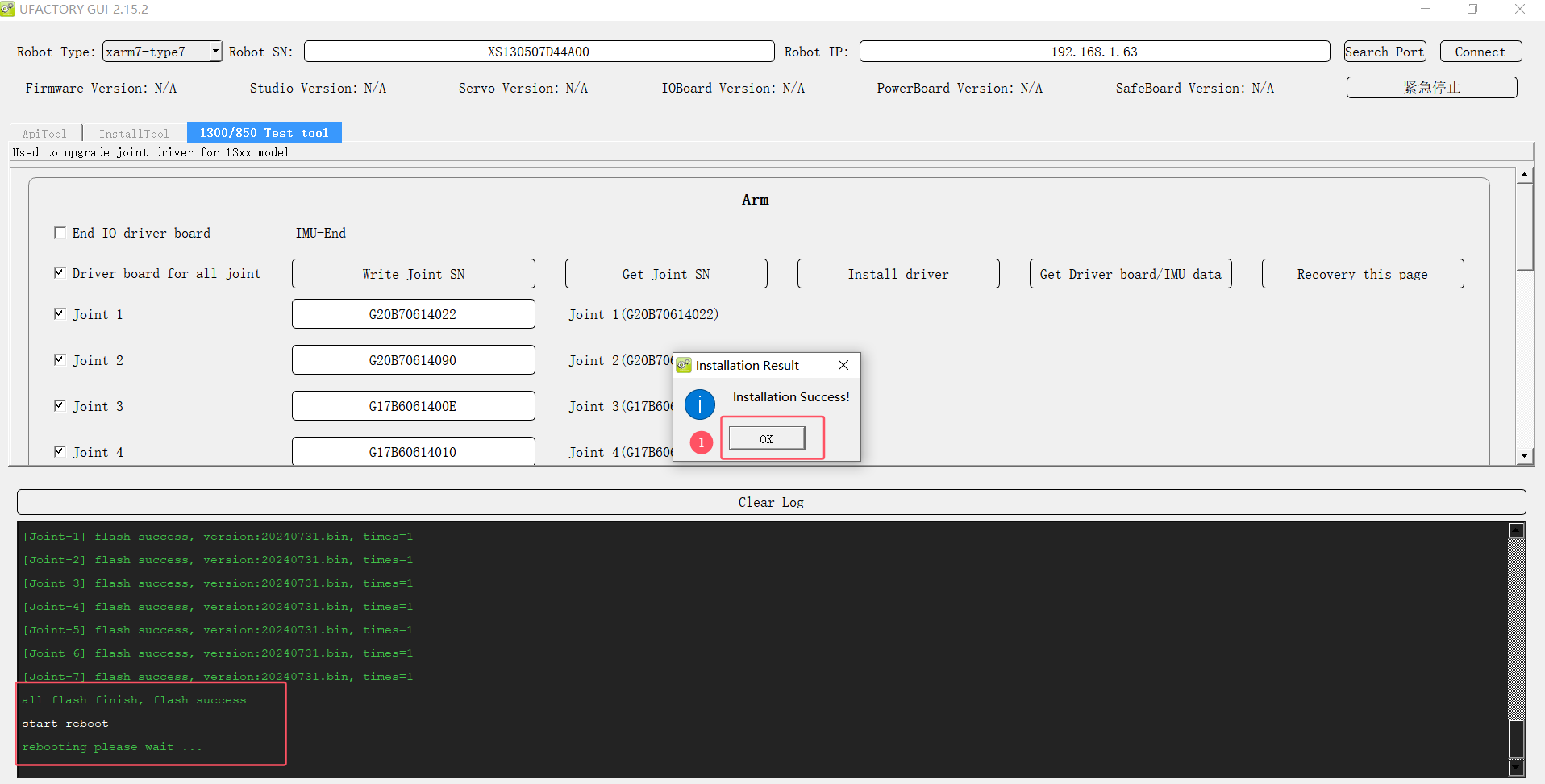

The tool will automatically load the joint firmware from ...\resources\firmwares\850_1305board. Wait for 1-2 minutes while the arm reboots itself.
After the reboot, the servo version should now be V5.0.8.
